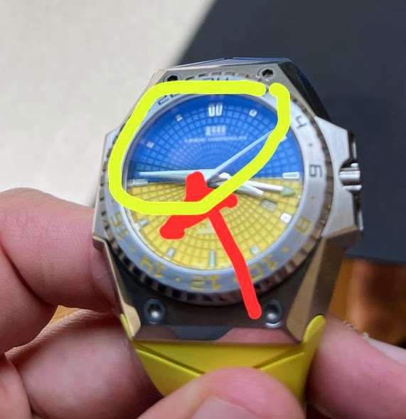

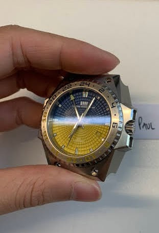

I had the same problem @Fiddy1 . It was returned from Linde Werdelin in the UK after having been polished. I thought it was on the underside of the glass, difficult to take a photo plus being frustrating as you could only see it in the light at a special angle. Linde Werdelin sent me a waybill to the UK the next day and my watch was returned within a week. I appreciate their good service. I hope all goes well with your watch. :)
Vis vedlegg 308100Vis vedlegg 308101
